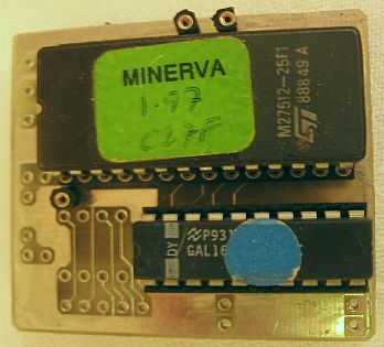

Minerva Mk 1 Board
Based on the original Minerva Mk 1 replacement QL ROM, this version adds a battery backed clock and RAM, along with a Philips I2C bus system for interfacing. The battery backed RAM allows a quick start of the QL to preferred mode. The I2C bus allows for devices such as analogue and digital I/O to be attached.
